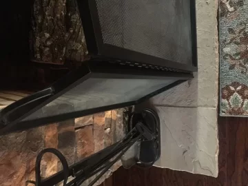

I used them too. They are called hearthstones and are not regular pavers from home depot. 20-30$ each. Manmade. Choice of colors. Color is integral, not a coating, edges are hammered or chiseled looking. Concrete based product.

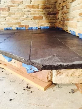

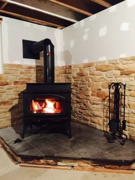

This is very similar the what my wife and I modeled our hearth after.
[Hearth.com] Where to buy hearth stones? [Hearth.com] Where to buy hearth stones?

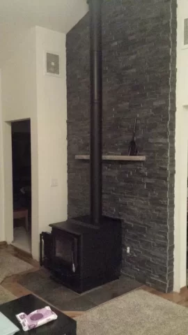

The stone on the wall is a cultured veneer stone that was super easy to work with. Well the stone under the stove is solid 12x13 blue gray lime stone pavers. We got both at a local stone/landscape wholesale center.

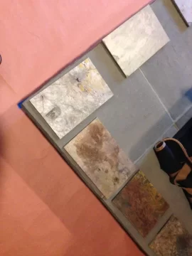

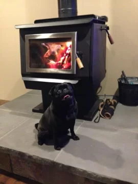

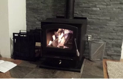

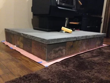

Here are mine.
[Hearth.com] Where to buy hearth stones? [Hearth.com] Where to buy hearth stones? [Hearth.com] Where to buy hearth stones?
I used a porcelain tile that looks like slate for the base and then used real slate (color "carbon") for the backdrop. I used limestone with a hammered finish for the mantel. I wanted tile for the base because it is non-porous and would not stain no matter what. Man-made materials have their place.
These pics don't do it justice..kinda washed out looking.
