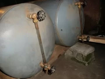

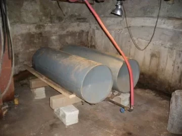

I am using two non-bladder expansion tanks that are 80 gallons a piece. They came out of a old elementary school's heating system. I think you can use old electric water heater tanks. There is a good post on how to set them up.
  • [Hearth.com] Where to buy expansion tank?
