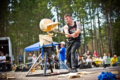

So what I'm looking for is one of those 4 legged stands that clamps onto a log as seen in timbersport competitions so I can use it as part of a baseball workout regimen...any idea where to find one or nifty ideas to make one at home?

Is it for high school baseball? Does the school have a metal shop? Is the metal shop teacher a baseball fan????
all the ones I've seen have been home made. A piece of metal pipe the right size, along with angle iron and a welder will get the job done.
Would be a good HS metal shop project as stated above. I would ask around and see if any local career centers etc would be interested in the project if you buy the materials, or if you are willing to pay, find a local welding shop.
No I'm outta college playing pro ball but one of my goals is to open a natural gym with various activities like this and splitting. I don't think my HS had a metal shop but I know the auto shop had a TIG welder and I was good friends with the teacher so maybe I could go there. So when you say metal pipe, are you talking like an 8 or 10" diameter bucket type thing to set the log in? What about implementing some adjustable clamps on the side for different sized logs?
i was thinking drill holes and weld in nuts to the large pipe, then use threaded rod or similar as your clamp. Screw the rod/bolt through the nut to hold the log in place. weight should do most of it, just need something to keep it from wobbling.
You could probably fab something up without the round pipe just using angle iron. Make a square out of the angle iron or square tubing for the log holder, then same idea with the threaded rod/nut to secure it inside the holder

Fab shop - take the photo, your check book and the idea. They will put one together in a day. Oh, and plan to pay heavy for your gyms liability insurance.
