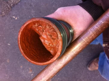

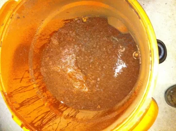

All seriousness aside, how do you guys clean your used tanks? They looked pretty clean when i picked them up. Idk if all the scale and rust bits fell off the sides during transport but by the time i got them off the trailer there was better than an inch of crud in the bottom. Filling halfway with water and flushed did nothing but make everything soggy. Ended up affixing a 1" copper pipe to shop vac and sucking everything out through holes. Worked well but each tank took an hour. First pc is about 5" in bottom of shop vac. Second is the reason why i was wondering how the hose was getting so heavy!

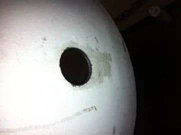

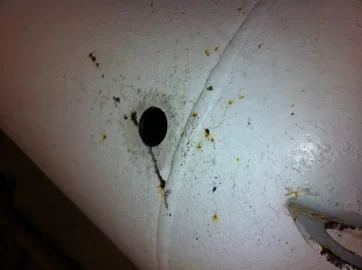

You are going to have to cut 2 openings in the bottom for your retun lines.When you have those cut in you can flush through them.
Two inch hole must not allow enough flow to move everythig. I woildnt want to cut anything bigger if i didnt need to. I was able to stick the vacuum rod in real nice from the end. They are very clean now.
