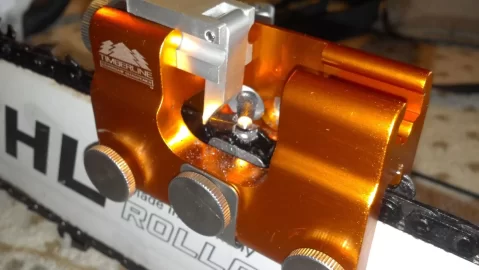

A saw shop (maybe your saw dealer?) should be able to sharpen them for $8-10 a chain. They should be like new if they know what they are doing. Or you could invest in a Timberline sharpener. Most foolproof way to get chains sharp that I've seen yet.I have to admit, I don't sharpen, I buy a new Stihl chain. I was never able to get them as sharp as new chain or stay as sharp for as loog as a new chain.
https://www.hearth.com/talk/threads/timberline-chain-sharpener-group-buy.85628/
http://www.timberlinesharpener.com/

Has anyone in NH used the Timberline and where did you get it?
I want to get my hands on one of those!
