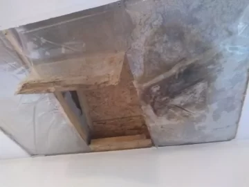

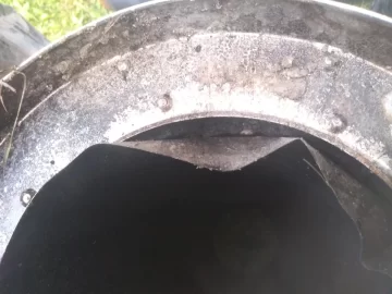

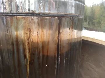

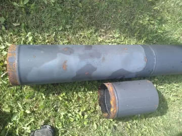

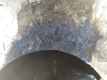

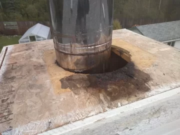

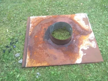

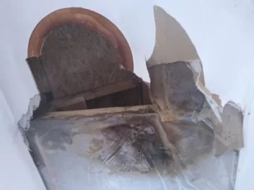

So my wife and I bought and moved into this house the first week of June. Basement home. On the main floor there is a BK wood stove and it was obvious the installation was not done right. Concrete board leaning against the wall behind the stove. Single wall flue pipe with obvious signs of a chimney fire. Stove has no side shields for close clearances, too close to the wall behind. Single wall flue 15" to wall, heat shields on floor not installed.

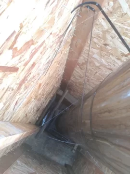

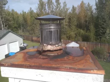

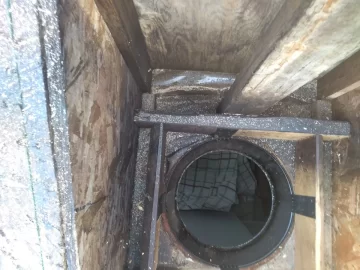

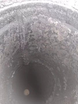

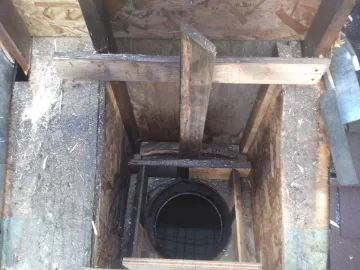

Top of chimney chase class A against plywood top. Banding near top holding chimney centered is that plastic/vynil type. Plywood top charred in 1 spot from burning dripping creosote. First joint down from top, the inner pipe buckled in. (Icing?) Also you can see where creosote was boiling out the outside of that same joint. At the bottom of the chase it was black. Smoke and creosote covered. Backing paper of drywall around support had been burning as well. Smoke/creosote seeped between insulation and vapor barrier up to 2' away as well as between drywall and vapor barrier.
So I tore everything out. Threw the chimney off the roof as well as the chimney chase and associated framing. Removed insulation and drywall as well. I did have to spray a sealant over a couple minor spots where smoke/creosote seeped onto the trusses. Fortunately the chase mostly contained the mess. A new chimney is now correctly installed. Sorry for the length but just wanted to share so people can see the results of improper installation, improper maintenance, and burning wet wood.
