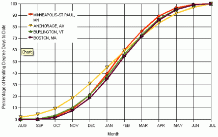

I made this chart from data I found for monthly heating degree days for various cities. There were a bunch more cities, but when i graphed too many they all started to overlap, making it hard to read.
The way to read this is that the y axis shows the percentage of all of the heating degree days that have passed and the x axis show the month. So for the 4 cities shown the 1/3 way point is early to late Dec, 1/2 way point is mid January, 2/3 point is mid Feb, etc.

Thanks for including us in the far north on your graph!
I live about 25 miles S of Duluth MN. I have electric baseboard in my shop as a back-up. The electric company gives me a nice graph that shows or heating season. It usually starts in Oct and goes to May with Jan and Feb being the highest usage months. Now that my boiler is in the garage I hope the electric doesn't kick-in.
