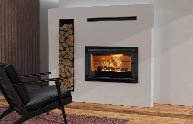

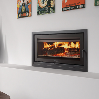

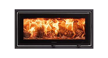

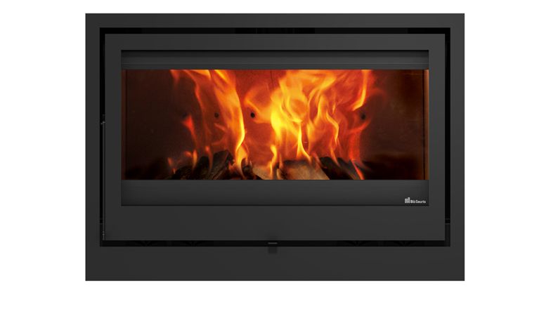

some of the units i found

Also, that first one is not an insert?
Their marketing has different terminology. An insert can be different there. This is similar to US marketing calling a ZC fireplace an insert, though many European designs are quite different in construction and requirements than US ZCs. In part this may be due to the prevalence of all masonry building construction in some areas.

and posted wrong unit on that first one
