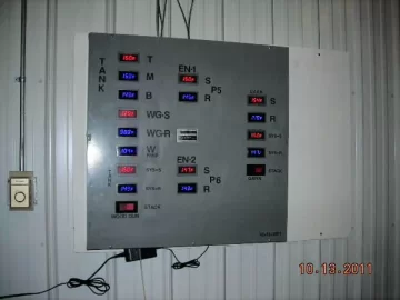

Just completed a monitoring panel at Deep Portage, except for the stack sensors for the Garn WHS3200 and the Wood Gun E500.

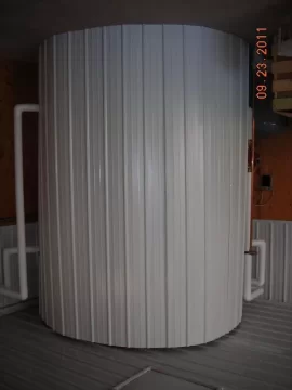

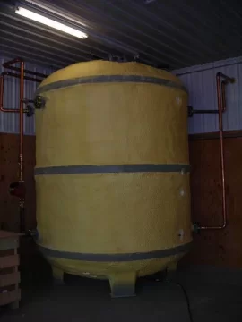

DP also installed a 4000 gallon storage tank to primarily serve the Wood Gun. The tank will allow the Wood Gun to maximize its potential, eliminate idling (and puffing explosions), and provide up to several hours of heat for DP during winter nights, and even longer during mild weather, without firing either boiler. The tank also can serve as additional storage for the Garn, and the Garn can serve as additional storage for the Wood Gun. We'll have fun this fall and winter learning the best operation of the boilers and storage to maximize efficiency and ability of storage to meet DP needs, particularly during the night.
I also have sensors installed to data log all monitoring locations, as well as outdoor temperature, and am looking forward to analyzing the data and provide updated performance data for the Garn, Wood Gun and the DP system.

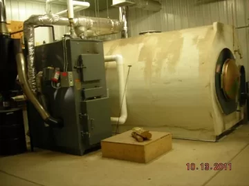

The three splits in front of the Wood Gun have equivalent heat value to 1 gallon of propane.
