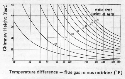

The research I have done seems to indicate that you need a certain amount of velocity of hot gasses going up the pipe.
Is there a scientific way to determine the size of the flue pipe?

These stoves are fussy about draft and their flue. Too little draft and there is a risk of it stalling and secondary combustion failing. That opens the potential for puffback. In this case it looks like your friend's installation is on the cusp. The short connector, to a 90 deg turn heading up the flue is effectively making this more like a 17' flue. It it was 25 ft of 6" flue, I might comfortable with that choice, but in this case from the facts at hand I would be leaning toward the 8" pipe with the consideration of adding a couple feet to the top if needed.
Here's the a link to the temp/draft graph:
(broken link removed to http://www.woodheat.org/chimneys/aboutchimneys.htm)

Thank you! He has room for either a 6" or 8" pipe. I see what you are saying about the elbow. If by chance the 8" pipe was oversized, what would be the ill effects from it?
The pipe won't be oversized. It's what's specced for the stove. They should be absolutely sure that the horiz. connector is kept as short as possible and with a definite pitch uphill toward the flue liner. 1/4"/ft min, but 1/2"/ft would be better.
