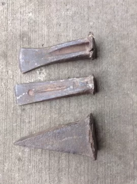

I used two thinner long wedges for piercing the wood then a big triangle block for prying open the log. Those Twisted ones I have heard work very well just have not personally used one but considering getting one can't hurt.
[Hearth.com] What Wedges Do You Use? [Hearth.com] What Wedges Do You Use?
They have nothing on them to identify them. I do know that they are old.

Hmm. Seems I just read somewhere that you shouldn't use mushroomed wedges.
I have seen and learned about using mushroomed heads in classes through work. It's a good practice to grind that off so shards don't fly off and penetrate you or something around you. It can make for a bad day, but I won't criticize anyone for using them as I have done it also. I try to keep them trimmed up but sometimes I just say eh, I'll get it the next time I split :)

I find that the mushroomed bits fly off by themselves if you whack 'em with a sledgehammer! ;)
Great, now you told everybody my secret wedge de-shrooming technique...
They probably should be cleaned up but I've never worried about it that much. If there are loose pieces I'll remove them but usually just get cleaned up by hitting with the sledge.

Can you spell "grenade" ?
One more nomination for a Darwin Award.

I have learned to look out for mushroomed heads, and also that many on here are typical like me in thinking it won't happen to them. It's settled, don't use mushroomed heads, or be prepared to suffer the consequences. Since I often split with my children somewhere in the backyard with me, I won't put them at risk even though I may think I'm ok. And I sincerely hope that the invincible members here also consider the risk to their family members.
I didn't think there was a blowup, nothing wrong with someone here looking out for another wood cutter. I didn't see the post your talking about but everyone here has valid posts and concerns. No body ever wants to see someone get hurt, the concerns about pieces flying off are valid. I appreciate the concern and will try to correct the mushrooming. Never a bad thing to get someone's else's view about tools or situations your in its how you look out for each other. I've been a lineman for over five years and was a bricklayer for over ten. When something doesn't look right call it out. DUMF was right to call it out, all is good I think, we're all adults here.

From experience, "mushroomed wedges" are dangerous. Sometimes to make a serious point of information, humor is used....as here.

So, please don't sledge hammer mushroomed wedges; grind them at ~ 45 degree angle all around. The end.
