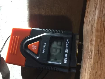

1st pic was a small 2" diameter piece of green maple, registered at 26%. It was outside and its 30 degrees.

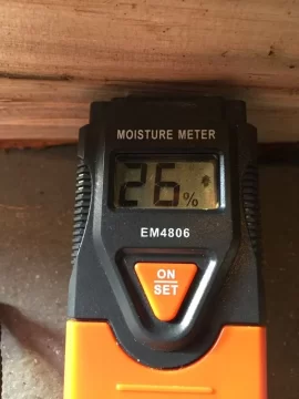

2nd pic is a larger slice of a red oak, that has been c/s/s for one year so far, top covered. Also registered at 26%.

I'm going to let these warm up a bit and see if anything changes.
