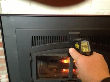

Insert here. I usually start closing my primary in increments at or around 300-350. Don't know if your setup will allow, but I take my stove top temp with an IR gun pointed thru where the blower air exits.
[Hearth.com] What temp do YOU close(begin to)close your damper
I also have a Rutland Mag. Thermometer on my doors for reference (not accurate of stove top temps).
Thanks for the reply...primary = damper? or primary= air control? thanks........nice looking infra-red....are they more accurate?
Primary air control. Door thermos aren't measuring the temp of the box. They're way off. Yes, the IR gun is way more accurate and the only solution in my case.
