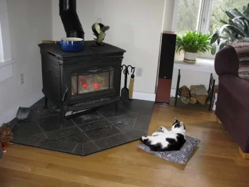

You could be fine. Our T6 is in a corner with a window on the left. The window trim starts at 37" and the actual glass at 42". The hearth extends beyond this point to almost the mid-point of the window. This is not an issue at all with the Alderlea which is only softly radiant from the sides. Your choice is good. I would stick with a convective stove and not put in a more radiant stove there.

and Begreen what are the dimentions of your pad, chinmeysweep online says for a T6 corner install the pas has to extend 56" from the corner
