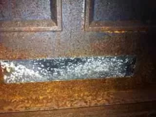

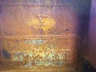

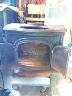

finally got the pictures up of the stove. sorry I took so long
  • [Hearth.com] what should I do with this??
Hard to see from the picture, is the area above the corners of the door arch smooth or dimpled?
I was referring to the surface face of the stove. I am wondering if this is a VC stove or a Taiwan knockoff. It's hard to tell from the pics.
Question?. Does a new stove install in South Jersey have to be EPA compliant? This may help, if any more effort on stove ID is required.
Good luck
