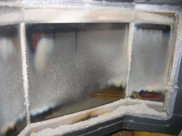

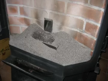

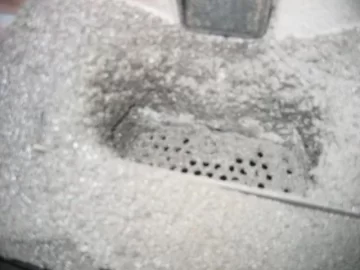

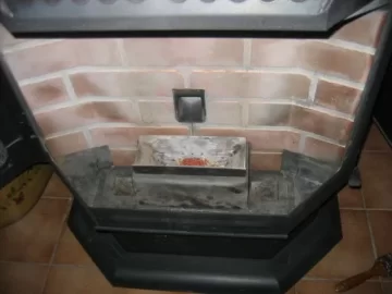

Well, it had been a full week since I cleaned the stove, although it was running great.
So I thought I'd do a cleaning, and snap some pics for your viewing pleasure. Sorry about the close-up of the burn pot...it's a little blurry.

LOL....yeah, maybe....I'm trying to post some more pics, hold on a few minutes.....
EDIT: Have been trying for 10+ minutes to post more pics, but system won't allow it....have no idea why....Oh well, maybe I'll try later
Couldn't add any more pics in the original thread...who knows why....maybe this will work.....

Code, I painted the brick panel myself with 2 colors of stove paint. The brick was a copper color paint, and the "mortar" lines are sand color......it was just about black when I got it (dealer showroom used model).

Yep, that was 24/7 straight burning, and no I NEVER have to scrape the burn pot.....it just keeps burning. I find that if there is too much ash building up in the pot, I open the air control a little more, and after an hour or so, it blows most of the ash out.
If you go back and look at the pic I took looking down into the burn pot before cleaning, you can see that the holes are open (the ash you do see there covering some of them was from me cleaning the heat transfer tubes with the slide right before I opened the door)
