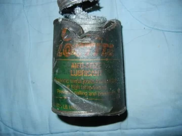

Can lasts forever is a overstatement:) This can is well over twenty years old
  • What kind of Lubricant for the versa grate shaft?
Time to replace it Bio...... Looks worse than last time. It comes in a tube now btw.
