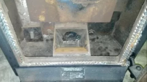

My Bottom feeder is an Old Englander (almost 17 yrs old). Its design has changed greatly from todays same model. My Fathers is an 01 is only 6 yrs newer. But the wear plate is larger and flatter. With only a little angle at the very end. My entire wear plate is on an angle. Still burns well. But if left alone for 12 hrs, it starts to look bad. It will still burn. But to help the flame and efficiency, I will scrape the end chunk of ash of the end.

Done been had one in hand... Quite a few now. Hangin in the basement. With the woodeater crankin and just fired the furnace up after some pics of the pot and a quick cleaning.
The Other one- That is a bottom feed. Just a different type...
Harman, Englander, and Enerzone. All have a visible auger. They feed pellets on a horizontal plane. Which pushes the pellets into the fire (Under Fire / Bottom Feeder).

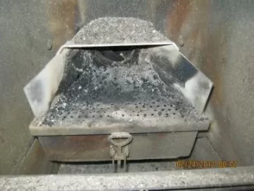

Here is a pic of my Englander and an Enerzone Euromax pot. Hope this helps.
