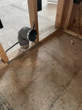

Your house will feel much warmer with that BK hooked to an OAK, trust me..Interesting. I plan on putting a blaze king there and my previous blaze king wasn’t connected to an air intake. I’ve never had a stove that was. The stove is going to go on a corner hearth pad facing out towards the center of the living room. So this pipe is supposed to connect to the bottom/back of the stove? Which means it will be protruding from the wall and sticking out towards/wrapping around to the back of the stove? Is this needed?
