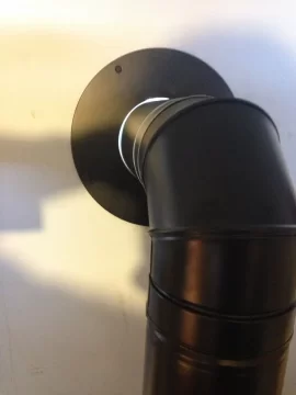

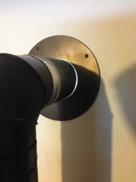

Clear RTV is all I have ever used.
Because DT doesn't get that hot, you probably don't need High temp.
Or install an oak to reduce drafts

Looks like an extension cord supported by clips.Thanks Dexter, I just may go with that. Yep the DT is not hot at all. Not sure why there still is a thimble and another air gap?

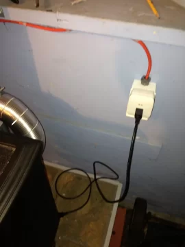

Got the Surge and AC wall box in today while it snowed all day!
should use SJ cord or UF wire in a garage and anything under 6 feet should be in conduit. but looks good for an extension cordYes, but it goes into a metal waterproof surface wall box screwed into a wall stud. The best I could do for a garage install.
Better than an extension cord lying on the floor that could get wet and run over. LOL
