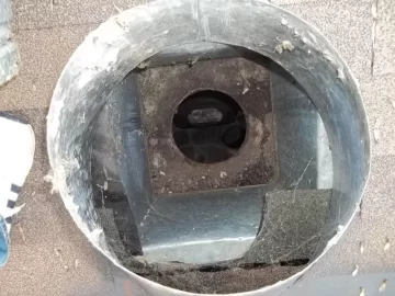

I took apart the chimney and took some pictures.
The support box does not support the weight of class A pipe.
The weight of the chimney is on the stove.
Is that a serious problem?
Single wall pipe runs into the support box and is connected to class A by male-male connector inside of the box.
I reversed the direction of the interior pipe and put it together without adding more support.
I used furnace cement and 3 screws for each joint except the connection of the Class A to single wall pipe which takes place inside of the "support box"
I will appreciate any advice (I have never put a chimney together before.)

I haven't installed Amerivent, but this looks like a predecessor to their TLC pipe. From what I can see it looks like it was installed incorrectly. If it installs the same, according to the manual, there should be clamping support band around the pipe that acts as a stop to limit the penetration of the class A pipe into the room. The support band also supports the weight of the pipe. The stove is not supposed to do this. The class A penetrates a certain distance into the room in order to maintain proper clearances when it transitions to single-wall pipe. There is a chart for this in the installation manual. Also, note that the male end of the class A pipe should be at the top, facing the chimney cap. The whole cap assembly looks like a cobbled aborti0n. Indoors, I would expect there to be a stove pipe adapter to handle the transition from the class A pipe to the single wall. But this is an old style pipe, so I don't know where you would find this piece. Maybe woodmanspartsplus?
Amerivent Catalog and Manuals:
http://www.americanmetalproducts.com/products/amerivent/chimney-systems/tlc-5-8.aspx
Here is a picture of the cathedral support box and the single-wall adapter:
http://www.woodmanspartsplus.com/49...merivent-All--Fuel-Roof-Support-Assembly.html
