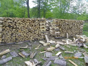

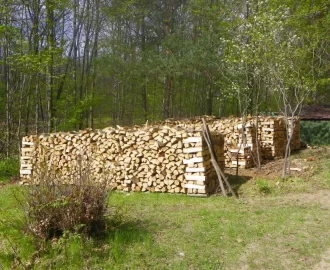

In addition to the important things about drying wood, how you stack that wood also has a big effect. For example, if you look at several pictures folks have posted you will see some that are stacked and looking good enough to use as a foundation to a building! Others you will see are a bit hap hazard while there are many in the middle. Believe it or not, those stacks that are hap hazard will tend to dry the fastest. The reason is the air circulation. If the wood is stacked really tight, then there is less air circulation. Stacked loosely = good air circulation.
Many have accused me of stacking really neat and tight but I don't think so. Below are two pictures of a couple wood piles. Except for the junk in the second picture that I had yet to clean up, the stacks are neat but if you look closely you will find they are stacked also rather loosely.
[Hearth.com] What is better for drying wood... wind or heat? [Hearth.com] What is better for drying wood... wind or heat?
