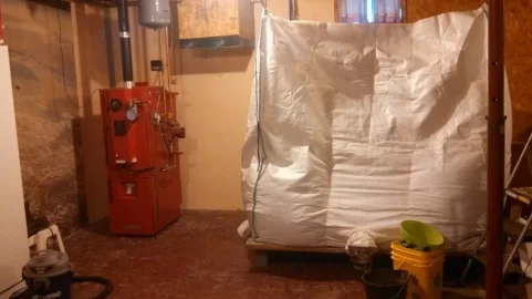

Hi! I was trying to find a way to transfer my pellets from a 4 1/2 ton storage bag to my boiler. It a short distance but the bag is really close to the floor. Any suggestion? Homemade or bought. Thanks for your time

Search for methods of moving corn on You Tube and you will see many methods. I use a vacuum cleaner, with a wood working dust collector 3" valve. Vacuum sucks the corn in my case, fills the vacuum cleaner, then I put a pail under it, shut off the vacuum, open the valve, and corn fills my pail, or hopper.
