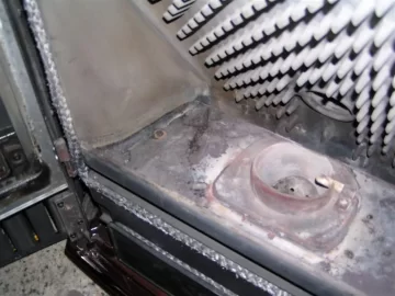

Xena said:I use the tool that came with the stove.
It's in the pic to the right of the paintbrush.
marine5068 said:The long wood-handled scraper tool that came with my Enviro Evolution pellet stove.
I just scrape the crud out and turn the pot upside down over the ash bin before I remove it to clean the chamber with an auto-parts round cleaning brush(they're cheap at the Princess Auto store).
Any hardened-on clinker is smacked with the tool edge to knock it off the pot.
Been doing it this way for 5 years now and the pot is always easily cleaned.
