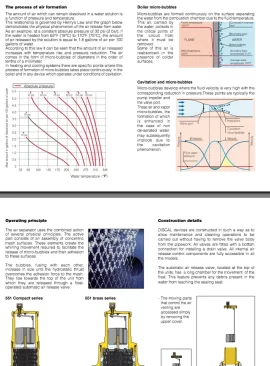

A good air elimination device is a must. Be sure the system is leak free first, clean and flush, fill with good quality water. Hydronic treatment is always a good idea. A tight system without any additional fill water should be fine also.
