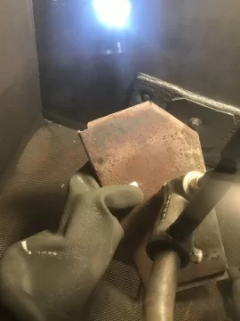

Just had a consultation on types of blast media, their aggressiveness and type of finish for cleaning black carbon and white calcium on dirty rust parts (Burn pots, baffle plates and augers...etc) with different blast media and it’s re-usability!
Which should I use for steel and which for cast iron?
I came up with 3
1. Black Diamond from Tractor Supply
Medium grit that is somewhat reusable. $8 50lb bag
Semi rough finish but cheapest by far
2. Glass Beads from Kramer Ind. $70 for 50lb bag
Medium / Fine grade and is re-usable
Smoothest finish but less aggressive so more passes to get a clean finish.
3. White aluminum oxide
90 Mesh
Tougher finish but more aggressive so less blasting time to clean.
See pics
Pic 1 - Black Diamond also called Black Beauty made of coal slag
Pic 2 - description of glass beads & white aluminum oxide

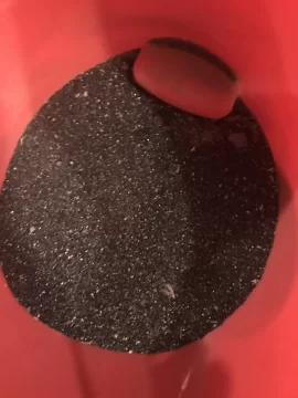

Pic 3 to 5 - Glass beads 50 lbs
Pic 6 to 8 - White Aluminum Oxide 50 lbs
Here is one comparison between Black Diamond vs Glass Beads
