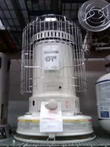

My Keroheater I call "Stinky" makes a good backup especially when there is a power failure! See pic below in Home Depot!
  • What Backup Other Than Oil or Propane?
