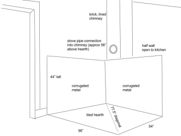

* House has a brick chimney that runs up the wall behind the tiled hearth with corrugated metal walls (rough drawing attached) - current stove has top flue exit, then approx. 2 ft vertical stove pipe into a 90-degree bend, into another 2-3 feet section (all single-walled, with almost certainly non-code clearances) to the chimney connection. Total height difference from top of stove to top of chimney is probably 15-18 feet with 2-3 lateral feet in the stove pipe run

* Dimensions in the vicinity of 23-26” wide and 20” deep to fit well diagonally on existing hearth; would be nice to have top and rear flue exit options

What are we missing in our thinking here? Anything you see differently that might push us in one direction or another?
