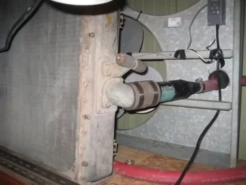

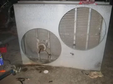

I have done this with mixed sucess. If the air conditioner exchanger is in a heated area already it will work just fine. In my case the fans were so strong that on a very cold day in a un heated shop the fans sucking cold air and the tubes being so small I literly froze the water in the lines.
It did puke out a lot of heat when using it. I have since cut the unit in half and use only one fan behind a big detroit deisel bus rad.

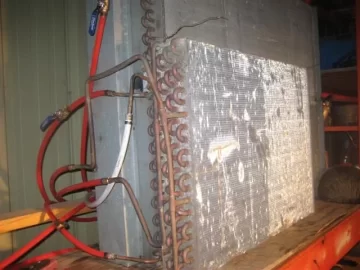

Here is a another picture showing my old set up using air conditioner type heat exchangers.
I had put a second exchanger in front to slow the air flow down, worked okay
I now have the smaller excahnger in a furnace duct.
