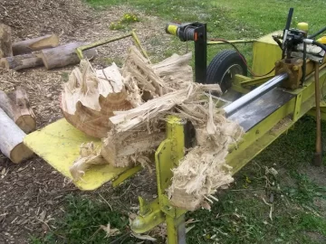

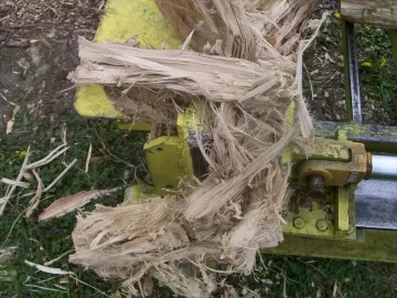

I think Jags or Backwoods had a photo of splitting carniage, which pretty much says it all.
That would be Jags.
We burn elm almost every year but we don't cut it until it is dead and the bark has fallen off most of the tree. Most of it splits very nicely then. Cut it and split it green and it is a mess.
