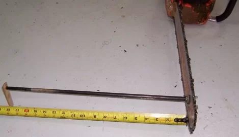

Made this because I'm no good at estimating the lengths as the log gets bigger/smaller diameter.
Easy on & off (wing nut) Small logs, mark & cut. over 16" diameter (rare) I walk down the log & mark, then remove it to make the cuts.
Old graphite fishing pole.
Sometimes i put it on my small saw & use it to mark the length.
