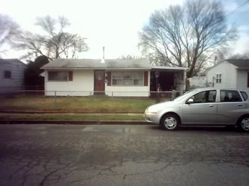

I hate to pay the electric co. I want to absolutely minimize my my bill, and thus the hold they have on me. I need about a 10 hr window of leaving to when I return that I can feel confident that the house will be comfortable. It's just me and 2 dogs now, so it doesn't have to be a steady 78 all day. I feel that soapstone is the way to go. I am heating approx 1200 sq feet, with fair insulation, and storm windows. I do plan to insulate the floors in the crawlspace this year. Attached is an exterior phot of the house. It is small, but has vaulted ceilngs, so I have a lot of "dead air". I put in a ceiling fan in the Kitchen/LR about 2 weeks ago, and the difference is amazing.
HIGHBEAM- If you read this, NICE WORK on your Heritage!!
House and car for scale

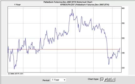

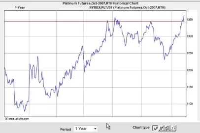

I just think that the catalytic stoves have a much broader operation band where everything is sweet, whereas the non catalytics have a fairly narrow sweet spot which requires that the stove be matched to the heat load far more accurately to begin with. Unfortunately, with the way things are going with Platinum and Palladium and Rhodium, its undoubtedly more expensive to build catalytic stoves.
