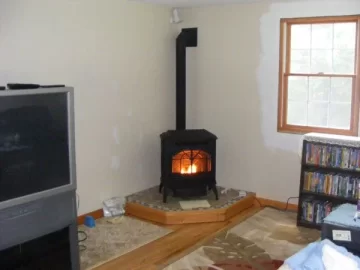

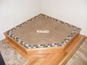

I finally took delivery of a Quadrafire Castile pellet stove and had it installed by my local dealer. I decided to build my own hearth pad as I wanted one raised up a little off of the floor.

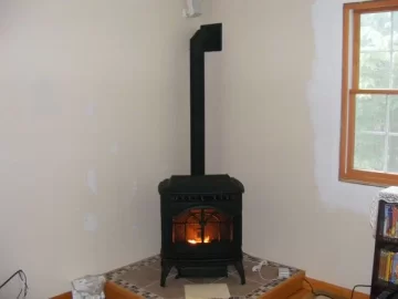

The photo of the hearth is just before I began to apply the grout. The other two are from the trial run while the installers were on site to verify everything was working ok.
Evertything ran fine. We tested it with a bag of New England premuim pellets. It was a little odd running a pellet stove on a warm sunny day (seen few of those for some time) and let it cook for about an hour before shutting it down.
I intend to run another AC outlet to neaten things up a bit All that remains is to get the walls painted and my remaining molding installed then wait for some cold air to arrive. Lastly to schedule a visit for the Insurance company to give there final ok.

Very nice set up. That should keep you warm next winter.

Nice setup!
You won't be disappointed with your Castile. Just keep that burn pot clean and you won't have any problems.

First of all, that is a really beautiful hearth you made.....looks great with the stove sitting on top and burning away.
Secondly, yes, make sure the insurance co. has all the info so if there was ever a claim, they can't deny it saying they never knew you had a pellet stove, etc. Also get a good surge suppressor on that stove.....something like this is what I use....and it's on sale for $5.00 right now....it has good specs: www.radioshack.com/product/index.jsp?productId=2454736

Nice setup...congrats!

nice pad.....I built mine and will post pics soon also.

The pipe size is a little confusing my receipt quoted 3" pipe and 2 weeks before installation we opted to change from the direct out behind the stove to an up and then out configuration with a cleanout T behind the stove.
At that time they asked 3" or 4" and I said whatever you guys think best and left it at that.
According to the Dura Vent catalog wether 3" or 4" pipe add 5/8" to get the outside diameter.
Eyeballing the pipe while holding the tape measure it's definitely over 4" so the long answer is it's got to be the 4" pipe. I fully expected to pay some additional money for the new configuration, but the dealer said we were all set.
I do have to say I was really satisfied with the dealer before the sale and after the installation. Satisfied enough to return in a few weeks to purchase a stove vacum to clean my stove. I have read some disparaging comments about dealers on here, but our experience was excellent.
I understand that there are different opinions on "up and then out" verses going straight out. We chose the up and out to give us the ability if need be of changing stoves in the furure without cutting a new hole in the side of the house. We would simply change the pipe length. Lastly because we have about 4 1/2' of verticle pipe we should have the added benefit of a natural draft going in cases of power outages.

Nice looking stove/pad!!

Lessoil your pad came out nice also. Your right I didn't think the pads I saw were a good value either. They were all about 2 inches tall and the insides were particle board with an oak trim molding. A 2" high pad my size would have run $495.
