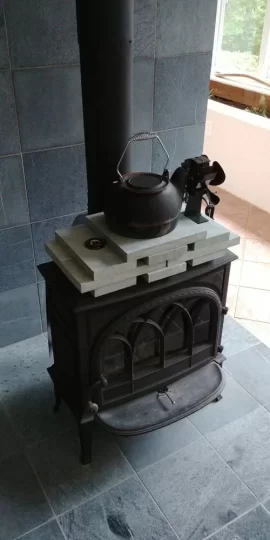

Got it. I'll give an update here after I use the stove a couple of times. I ended up using 12 eight pounds blocks, each measuring about 12x5x2 inches. I built an alternating crisscross pattern, much like with a firewood stack. It ended up being four levels high, with room in between each brick for air.
Pictures to come.
Here it is. All said and done, I figure about 110 pounds of total mass added to the stove.

The heat will still be in the house. It may be a little less dramatically reactive, being slower to warm up, but then releasing heat as the fire dies down. When we had the Castine, temp swings in the house due to the burn cycle were notable so I will be curious to see how this works out for you. Keep us posted.
Reactions: CentralVAWoodHeat
That's one of the big reasons why I am trying this. The temperature swings we get are very extreme as well. I'm trying to even it out a bit.
Result:
I burned the stove last night for the first time this year. I found that it took longer to heat the house and consumed more wood to get the house up to temperature (3 loads instead of 1). Yes, the stone retained a lot of heat but it wasn't really hot enough to be useable heat. I ended up with a cooler house and warm soapstone tiles.
Also, those who suggested the added stone would insulate the firebox were absolutely correct. I observed that I could barely get near the stove because the sides and front were pumping out so much more heat than normal. My theory is that, since it couldn't escape as well through the top plate, it had to either go up the pipe or be radiated to a higher degree out other parts of the stove.
I took all the tile off and am back to the normal set up.
