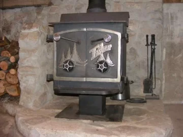

My Fisher Grandma Bear turned out to be a Fisher Teddy Bear. I bought it though {figured i can sell it if it can't cut it} For $300 it seems like a nice stove. anyone got any info? it does have a baffle and with drafts opened a 1/4 turn and damper at about 1:30 -2:00 it left me enough coals to get going without kindling. only takes 16" but will take big diameter.do I really need all the brick?I took the brick out of a shop stove once for quicker heat what is the advantage of leaving it in? most of my experience is with cast iron {no brick} This is the main heat source in my house and is run 24-7.it is located in basement of a 11oo sqr' ranch{2200 with basement}with open stair case to basement,and open floor plan, built by me 5 years ago with standard r19-r36 fiberglass insulation.I hope i won't be sorry when it's -20, my old comforter would keep it 68 in january if i left it 3/4 open and stoked it every couple hours with dri red oak. also, any thoughts on a fan i could put behind stove in back corner of hearth ?

Keep the bricks in, they help with combustion efficiency and also help protect the metal. Have you tried blowing the cool air from upstairs down to the basement, it will help pressurize and push the warm air up the stairwell.
