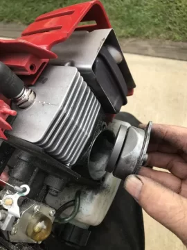

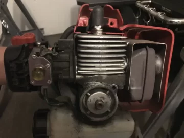

I have Sears Craftsman Weed Eater that is not starting now but worked the last time I used it.
After cleaning the air filter and changing the spark plug and trying some starting ether it still was a no go. So I took off the black plastic cover to the back side of the engine and tried pulling the starting rope handle. Then part 35 - The electric start cover fell off! So I put it back on and reassembled it and low and behold the weed wacker started right up with only one pull!
It worked for about 5 mins and gave a jerk and shut down. Now it will not start again so I took it apart and found damage to the part 4 - the O ring seal that seals the cover to the engine! Now if this seal leaked and causes the normal approx 90 PSI to drop down to 50 PSI or below then the engine will not start!

Pic 1&2 - Craftsman weed trimmer similar to many other brands too!
