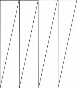

I will be making some wedges this week so I made this template, the measurements are 3.48 wide by 4.0.

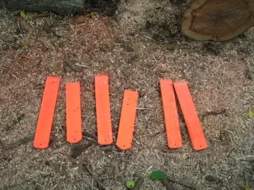

They dont even to have a taper,like traditional wedges.Just good hardwood flat stock 3"-4" wide,a foot or so long & about a 1/32" thicker than the saw's kerf,rounded & beveled on one end.I made a couple dozen years ago out of hard maple (what I had at the time) spray painted with fluorescent orange paint for visibility on the forest floor.You dont need them at first,but insert a pair across from each other once you're in the cut about 2 feet,then again about every 2 feet & repeat until you're about that far from the opposite end.They last a long time since they're just slipped in the kerf & not hammered on like tapered felling wedges.
