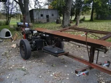

I did put my splitter (in the vertical) on a metal-decked wagon one time and loaded
a bunch of massive rounds around it. I could move things around better
waist high while standing up. Worked real good.
