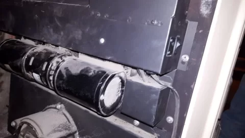

Hello all. Our Trinity wood stove blower just pooped the bed I think. Like 5 minutes ago. It was running fine all winter. No odd noises from the motor or anything. The outlet has power. Does anybody know if you can still get parts for a Waterford stove? Or better yet how to trouble shoot the blower or snap switch? Thanks for any help. G

[Hearth.com] Waterford Trinity blower just stopped Well. I was able to easily remove the blower assembly and separate the blower motor from the duct work. Wow. That thing has had no love over 13 years. The whole unit is totally plugged with ash and dust. The squirrel cages will not spin freely at all. Tomorrow I will try to free it up and bench test it. I'm afraid I may have smoked it due to lack of maintenance. I'll post back. G

Could be the motor bearings have seized. If so they will need to be replaced.
13 years and have never seen a cleaning? Wow, that's durability. Cleaning the blower is part of the annual chimney/stove cleaning. If you can't find that part, a small motor repair place or perhaps a Grainger store might be able to supply a new motor to change out. Good luck with your hunt.
The motor bearings are seized. The bad news is that the blower is no longer available from Lehmans the only parts supplier left for Waterford wood stoves. The good news is that the blower is made by Fasco, an american company and is easily avalilable from Amazon or an electrical supply house. So for the record a Waterford Trinity MKII woodstove replacement blower is a FASCO Model A-125. It is an exact replacement. Approx cost $135.00

I have. Will install tomorrow night. Very easy.
Don't know if the Dayton will fit. Sure looks the same. I searched out the FASCO A125 because that is what the old one was.
