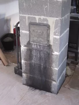

We fired up our old stove for the first time about 3 or 4 weeks ago, connected to a new block chimney, and we have water dripping out of the cleanout. It looks like sticky creosote but it isn't all that sticky - just black. See attached picture - it looks like a lot in the picture, but it isn't that much.
The chimeny is about 30' high, tops out about 4' above the ridge, is lined with 8x13" flue tile and is insulated with vermiculite. We try to run our stove at a steady, fairly hot temperature, but we don't get great burn times and our house is well insulated, so we only need to fire it up a couple times a day. Thus, it does cool down periodically. The stove has a 6" flue, so the flue tile is definitely on the big side for our stove... We are also on the top of a hill, so we are wondering if perhaps the chimney is too cold at the top and the steam is condensing before escaping the cap? But we are not experts by any manner of means.
Any thoughts of what is causing this and how to deal with it? I ask because we are about to put down hardwood, and this is clearly not a situation that can continue.
