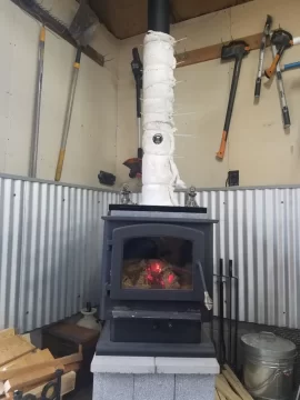

NC30 was having draft issues on this warm wet evening 60°F . Decided to try some Kaowool on the lower 4 foot of single wall. Surface temps at 18" went from ~200°F to about ~325°F. No draft issues now.
The 1" Kaowool might be a bit much. But in essence, from my understanding, I just basically made this double wall pipe+ the lower 4'.
What am I missing from an understanding point of view? Hack job for sure, but experimental on my part short term 1 burn.
