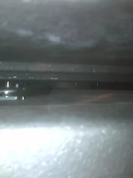

I've had the insert for about 2 weeks now and have done extensive reading on this forum prior to burning so I thought I knew what I was doing. I was using an IR gun to monitor my stove top temps which I have since replaced with a Rutland thermometer. Problem was the IR gun would give me readings that varied by about 300 degrees depending upon where on top of the firebox I aimed it. So I had started a fire with the firebox pretty full of splits, had the damper wide open to get it going, check it with my IR gun and though it needed to heat up some more (was less than 500), so I sat on the couch and let it burn some more. Well I went back to check the temps with the IR gun about 10 to 15 minutes later and noticed that the outside top of firebox was glowing. I immediately shut the damper all the way and it stopped glowing within a few minutes. The fan was on high the whole time. After it cooled down I looked it over and saw no signs of damage except that the top of the firebox is now warped and is no longer flat. It sticks up a little bit in the middle maybe 1/4 inch when cold and 1/2 inch when hot. It also creaks a lot when hot (not sure if this is normal). Did I ruin my stove? I have since used it and it seems to be working just fine and much better now that I have a real thermometer.
It's very frustrating that the manual that comes with the stove has little in the way of what temps to run it at or how they recommend you burn it. Telling me I've over fired it once it's glowing does very little to help me know when it's approaching that point. No doubt it's my fault this happened but just a little frustrated they don't give you better documentation with something that can be dangerous if misused.
Anyways I've attached a pic. It's the best I could get. Please let me know if you guys think I should be concerned.
Thanks

I am sorry but it sure sounds like you put that car into a tree so to speak. Especially if you are talking about the exterior of the stove being warped. If this is a baffle plate, then perhaps it can be replaced. I'd call up the stove shop you bought this from and talk to them. Perhaps they can get you a new one if they can find reason to believe the overfire occurred because of a faulty gasket or something?

Where did you buy it? What make and model is it? What were you burning and how much? Personally I would have opened the damper and closed any vents.
Lots of wood stoves have glowed, especially inserts where you can't see behind the surround. What you are looking for is cracks. Warping the top plate isn't a good thing, it usually happens many years later. Not in two weeks. Was the glow actually all the way at the front of the top plate, or around the flue collar?
A good sign is that you didn't hear a loud "bang" sound and that you can still control the air as before.
I have the same thing on my HI300 for a few years. Hasn't been an issue. I got that sucka glowing a couple of times myself. I occasionally think about pulling it out, taking the top off and welding a new heavy plate on there myself- but I don't think it's a big deal.
Sorry to hear about it. I have an IR gun, but mostly operate it by watching the secondaries and touching the mantle. I have never noticed the stove top to glow and the mantle will get to 300 deg. on occasion with the interior of the box ranging from 775 to 850. The secondary tubes will be glowing at this point. However, in light of your post, I opened my door and looked in at the top of the stove and noticed that I have a bulge on the top in front of the flue pipe, not much, but it is there. The stove works fine, though.
Thanks for the replies everyone! I'm glad to hear that I'm not the only one with this bulge. Like I said the stove still functions just fine and I don't see any signs of cracks or broken welds. Also, it still passes the dollar bill test. I think to be on the safe side I'll still give the installer a call just to get their take on it and have them inspect it if need be.

BrotherBart the glow was about in the center of the top plate a little in front of the flue collar. I had to actually look in there when pointing my IR gun to notice it. It's not as if I noticed it from the couch.

I have actually been meaning to do a post aboput this. I have had an HI300 for two seasons now, and I have got the top of the stove glowing many times. In fact, I find it difficult to not get it glowing during the wide open draft beginning phase.
I wonder if this is an issue with all HI300 owners, and they just aren't aware of the glowing. You have to look back inside where the air blows out to see if it is glowing. Mine has the bulge as well. As far as I can tell everything is working okay, but it is a little bit of a concern.

I've had a few run aways myself where the stove top was glowing. This was concentrated around the stove pipe connection and out about 6 inches. This has happened with a full load with wide open draft. It has also happened with a partially closed draft (about 1" from wide open). Each load is different so be careful.
Here's what to look for. Take a flash light and look inside the blower chamber at the weld seams along the entire stove top. You should see a nice bead of welding. If your stove top is warped, it most likely means it got hot enough to soften the medal and then it harden this way. I would say you are safe if your weld seams along the sides are still there without any cracks. You should also take a look inside the stove above the baffle. Hopefully the stove top is not too close to the baffle (meaning it sagging too much).
