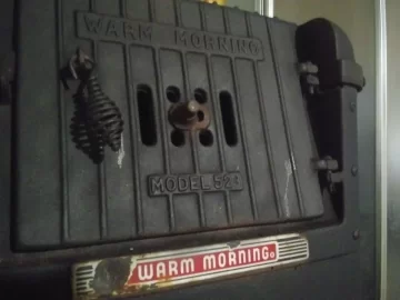

Bholler. U approve of this?
I cant tell from those pics. Most of those were coal stoves but they made some for wood. Does it have shaker grates? And where is the air inlets other than on the top loading door?
Ok i looked it up the 523 is a combo wood coal unit. But it will be a much better coal stove than woodstove.
I will say it is better than the homemade stove with no intake or the buck running through 6"
So do u approve of the 523?????
I already told you what i thought of it. As long as it is in good shape it will work. But as with most wood coal combis they are better coal stoves than woodstoves.
But if it is goid repair it is a far better choice than the homemade stove with no air inlet.
