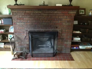

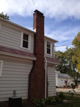

I am assuming my liner will be tall enough. I know it is dangerous to assume, but I have attached a few pics to help show the height of the chimney. There are two flues, but [Hearth.com] Want an insert, but installers are all over the place...Help [Hearth.com] Want an insert, but installers are all over the place...Help
only one flue is currently used. The other flue used to be for a hot water heater, which is now a direct vent. The base of the fireplace is about equal with the last row of siding on the outside picture. Ash dump is in the basement.
Looks more like 20ft to me, but that's a guess.
