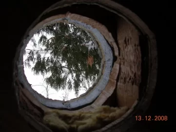

Hello, I am in the process of installing a pellet stove. Is there a company that manufacturer's a wall thimble that can pass through a 13" wall?

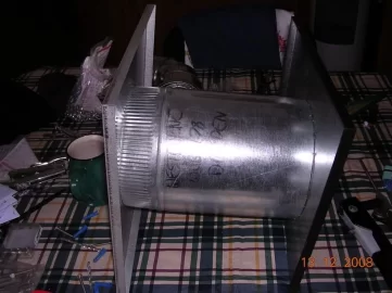

Use a standard thimble with a piece of round ductwork that fits over the round parts of the inside of the standard piece.
