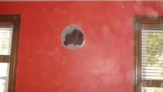

I installed our new Mansfield yesterday. Wooo!! I used a wall thimble kit, and did not see anywhere in the directions on what to do with the insulation in the wall. I just cut the hole, removed enough insulation (blown-in celuose) and put the thimble together. Is it ok that the insulation will eventually settle and rest against the outside of the wall thimble? I imagine it is safe..... The thimble gives the needed 2" clearence for the class A pipe that goes through the wall... Is that enough?
Should I have boxed in the thimble so that the insulation will never come in contact with it?
Anyone else just let the insulation rest against the thimble?
Thanks
Chris

Yes, my insulation is in contact with my thimble. I have fiberglass insulation which I was not able to get to burn with a blow torch. I think cellulose is also very safe but didn't read this entire web page. (broken link removed)
I believe the air gap in the thimble is supposed to be the required minimum distance to combustibles. Niether insulation would be considered a combustible.
