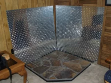

Here is a photo of where the stove will go with the floor hearth and the wall shields, I just figured out how to post a pic. (Or at least I hope I did). I have been trying since yesterday. Gene
