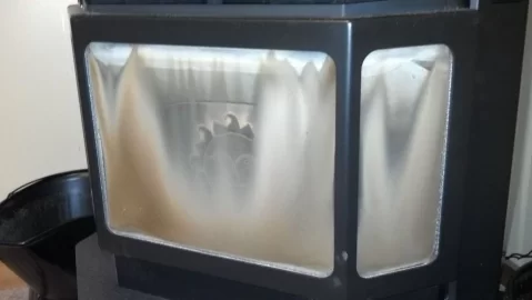

Its normal for glass to soot up, especially burning on low. Almost all makes and models soot up the glass.I notice that every time I clean my stove (which is every 7-10 days in burning season) that I need to clean the glass.
Mine will in a couple days burning on low.
Yeppers.... Couple days is all it takes. Let it go a couple weeks and you'll see what "Dirty" means...
As long as your cleaning that Vernon as often as you say, your not gonna get the build up Mike describes.
Best way to tell, is the color of your ash. A lighter grey to a lighter brown (grey being better), isnt bad. When you start getting a black to dark brown soot... Then you may have a problem.
Here is my glass after about 25 bags... Or a few weeks. !!
Mike can you talk a little more about stoves that were "burned dirty" and firing the soot and how to avoid all of that? This is my second year with a Mt Vernon, and I notice that every time I clean my stove (which is every 7-10 days in burning season) that I need to clean the glass. That makes me think I'm not burning hot enough or long enough. With the Mt Vernon there's so many settings that its difficult to know what settings will allow me to burn hot enough to avoid what you are talking about.
