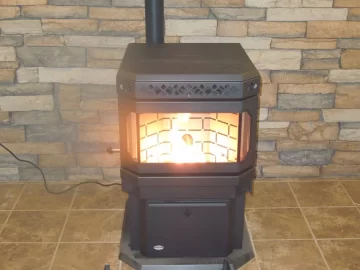

It was hidden pretty well and there was no indication of it in the book but I found it, thanks for the input guys. I really appreciate it. Here it is in all it's glory. [Hearth.com] VF-100 Initial Setup
Beautiful Hearth... Beautiful Stove .... Welcome to the Forum :)
Is there an Approved Surge protector on that stove ;)
I want one!
i believe that stove is the same as the meridian i had.hole was at front of stove below the door
VF100 is the EF3 with different stickers. (the louvre is different too)
To the OP, that is a nice looking set up, love the tile and stonework as a backdrop.
Ha Ha, there is an approved surge protector. Haven't figured out yet what to do with that cord though.
Is it possible to add a receptacle in floor behind stove - an all metal box and cover with approved wire insulation?
I like the idea of feeding said box with a remote s-protector & bat-backup.
