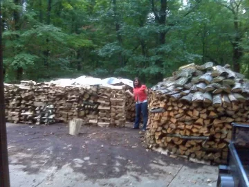

If you cross stack (which is a good technique to know for the end of rows to hold the wood in place) you will get tremendous airflow. You will not stack as much on a pallet but it is good for your first year. Basically you lay the wood out in a tic tac toe pattern or a lb sign # is as quick as I can do with the keyboard. Look at Backwoods Savage stacks and you will see it in a hurry. Here is a picture of my first year with a Holz Hausen on the right and cross stacks on the left for fast drying.

Thanks G&WN;, I was just out trying the criss cross stacking method. Is it just me or does that take some practice to get it to work right? I only have problems when it comes to the twisted gnarly stuff. The stack wobbles a lot. Will keep playing with it to see if I can get it to work. I do like the criss cross pattern for the ends I have been using t-post, but ran out. This saves me a trip to the farm store.

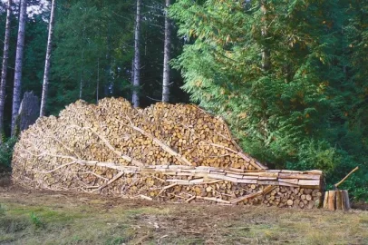

I forgot to ask, how many cords of wood does that Holz Hausen hold in your pic. Thats a neat idea. I ran across this tree design, and think that is fairly decorative also.
That's a great picture/stack of wood. I don't think I would want to take it apart to burn. Not that any of my neighbors complained about my wood stacks, but if the stacks looked like that, how could anyone complain.
Thanks for sharing.

Yes I have seen that picture of the tree wood stack many times, it was an art project for someone. With the cross stacking I have found on the ends that I make sure they do not lean out (away from the stacks) at all. It is Ok to lean inwards. It is best done with square, or evenly cut pieces. I usually just use this method on the ends of a pallet and stack normally in between, but it is a great method of getting airflow. That monster Holtz Hausen was a 10 foot diameter one about 8 feet high and probably held about 5 cords. I have torn it down and built some 4 pallet ones that only hold about 2 cords. I do miss the big boy it, it was a great conversation piece.
